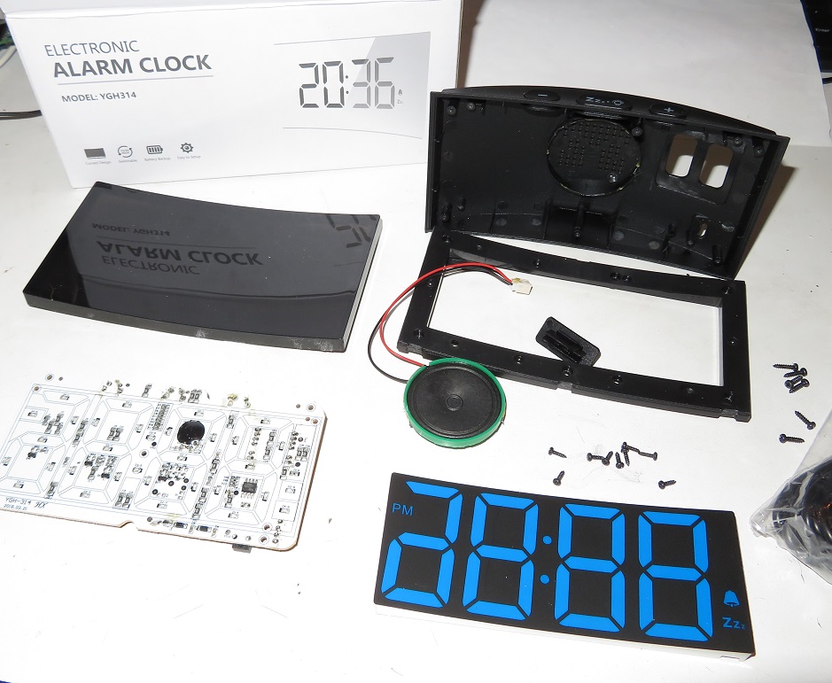

I could start with LED displays, but large ones cost a lot, so why not start with a $10 clock from Amazon? Which is what I did, back in an earlier life my job included building demos for trade shows. Back then on the suggestion of a co-worker many demos started with a trip to Toys 'r Us, with a toy re-purposed for an electronic demo. It was great to piggyback on the tooling of those toys. So here is my starting point--
My first surprise was that the clock didn't have large LEDs, but instead had LEDs mounted on board with light pipes for the digits. Sure I could 3D print something similar, but my time is also valuable and $10 saved me a lot of time. Originally I thought I could piggyback on the LED drivers, but now I'll just use a lot of individual pins and will switch to an ARMstamp.

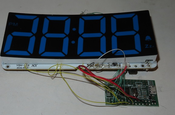

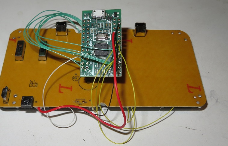

OK did some more probing on the main board, turns out it has 4 PNP transistors with resistors on the base for digit drive, and 8 common segment lines with series resistors. Removed the chip on board clock chip. So just need to add some wires. It had a diode protection for power input (seems useless on a USB connector. But I pulled that off and dead bugged a P MOSFET, resistor pullup and wire out so PWM can regulate the brightness. Power and GND and away we go. I like using 30 AWG wire wrap wire and hot glue, and different colors so I can keep stuff straight. Didn't much worry about the segment order hookup as that will get #defined anyway.
ANd how it will mount in the box
Now on to some programming

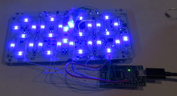

Modified the program to light up everything 82 mA at 5V

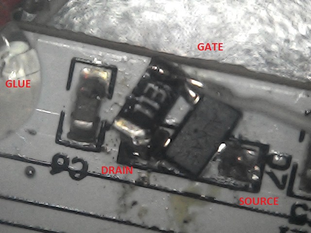

And a closeup of deadbug PMOSFET and 1206 pullup, got to use my cheapo USB microscope, that replaced my Intel Play Microscope that just ran out off software support.
