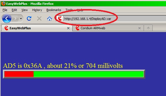

Here is a snapshot of the control page we serve on the EasyWeb
And the Easy web user page which dynamically shows a value of an AD converter.
