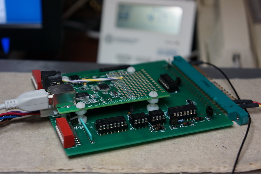

I have created an ARMmite device file for the Eagle PCB design software (Eagle Rev 5.11). This enables the ARMmite to be used as a daughter card on a larger motherboard (MB) PCB. It might be useful to someone else. The Eagle library file and a photo are attached. All I/O pins and 3.3V out (for pull ups) are brought out to the MB. The wire link you see from the power socket allows the ARMmite to be powered from the MB. I used 0.1" Header Sockets on the MB with pins soldered on the ARMmite to make it a plug-in. However it could be soldered in permanently using just Header Pins and then be spaced closer to the MB.
There is a free version of the Eagle software available but it is limited in board size and number of layers.
ARMmite Daughter Card.JPG (184.56 KiB) Viewed 20321 times

Bruce,
I guess I'm not "up" on Eagle devices. I thought Eagle was a PCB layout package.
What would be the advantage of this, over (say) an Arduino-compatible layout?

Yes, Eagle is a PCB layout tool. The ARMmite library posted enables you to include an ARMmite as a daughter card in your board design.
