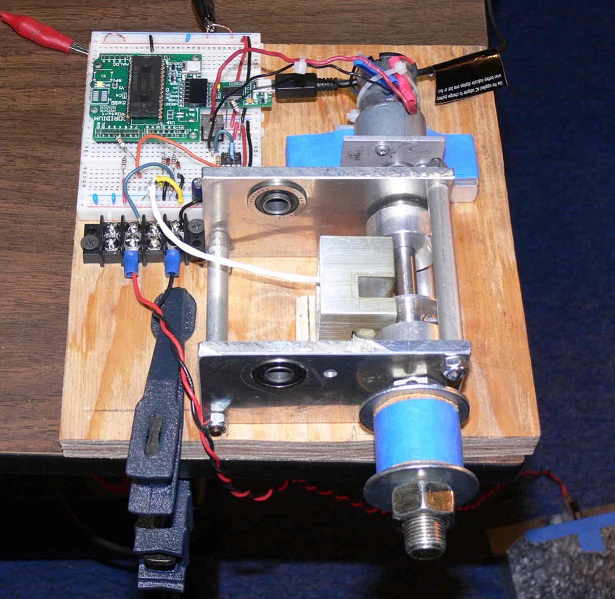

This is a $20 Coridium ProStart ARM computer.
Counts the number of preprogrammed turns and stops
while you set up a new coil. A tap on the foot pedal
starts winding again. One uses their hands to control
how the layers are woundfor the time being.
Just got it done.
- winder.jpg (165.67 KiB) Viewed 13555 times

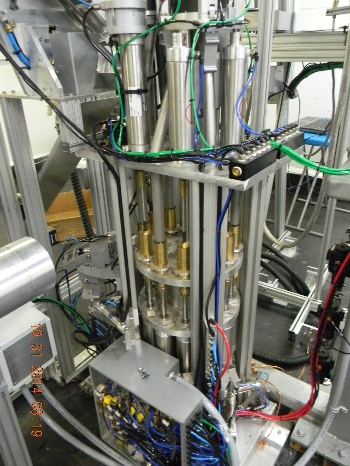

This is the turret of a multi-station rotary press making explosive devices (not ammunition).
This is one of five components in the system containing SuperPro boards. A multiplicity of tasks including materials weighing, sizing, mixing, depositing, and collating for storage is done by the processors, with one reserved for overseeing all the other processors. Commo is by RS232.
The box at the bottom contains a SuperPro and a 'mother board' with many SSRs and twenty air valves. All the apparatus is sealed and pressurized during operation to prevent intrusion of explosive dusts.
- DSCN1302.jpg (172.7 KiB) Viewed 13552 times
