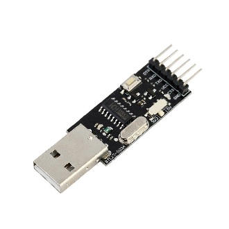

Re: CH340 TTL to Serial for programming
Posted: Fri Jun 09, 2017 1:11 am
I ordered a couple of these and they came in today. I changed the connector from male to female, plugged it in, updated the driver from the web.
And it works fine with BASIC. I have no idea how they can make these and sell them for $1.66.
