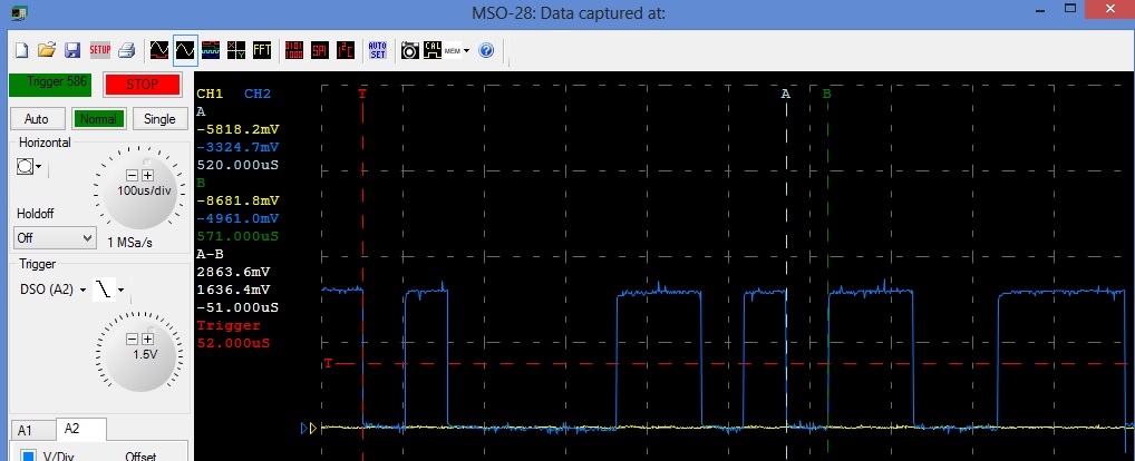

In our testing of the code we setup ARMs to echo what they saw on the serial port. Connected them to other ARMs streaming large amounts of DATA, as well as to PCs that were bursting variable lengths of data. Most all running at either 19.2 or 115 Kb. Done over a number of days, by 3 different people running independent test program they independently wrote. So we are pretty confident in it.
Also here is a scope trace of the first 2 characters going out, and it shows there is no delay between start and stop.
