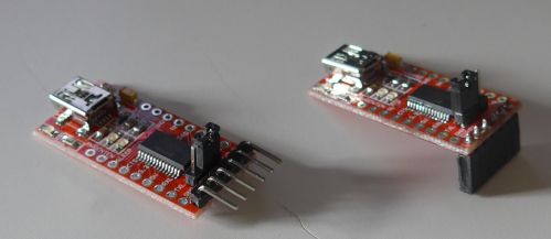

Before the latest hooplah about counterfeit FTDI chips, I bought some really cheap dongles from eBay. They just came in and I knew I would have to change the connector as these were males, and our cards expect females. But with some quick solder surgery I swapped the connectors. While they have to go on reversed they are functional for BASIC. So if you are real cheap the $2.94 seem to work if you have the female connectors and don't mind swapping them out. Personally I would buy the $6-7 and save the 15 minutes.
Here is the connector swap--
And how to connect to one of the boards
I updated the drivers to see if either were not real FTDI parts, but both seem to be fine. So these work fine for BASIC, but they do lack the second control pin used to put the NXP part into ISP mode for C programming. Though this one runs all pins to the edge so you could jumper it over.

Actually this is a TSOP28 which is still a challenge to solder to, but the pins are brought out to 0.1" holes.
Problem is, I soldered the wire on to add RTS to the 6 pins (no need to cut CTS as it is an input). When I reconnected the part the PID was reset to 0000 which is the symptom of a counterfeit FTDI part and it no longer works with my updated PC. So it was working until power was cycled and a new ID was read.
So if you want to use these, don't update the drivers, which I did intentionally to see what the issue was. This was on a Win8.1 machine which has been routinely automatically updated, but the driver looks like it has to be specifically updated to 2.12.0.0 to disable these. So for now I can't use these on my main machine, but can be used on other boxes around here.
