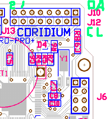

not having your Adafruit partnumber, I am guessing you are doing the quad pack .
I originally thought they had it on a shield - but its good they didn't
AS the SuperPro doesn't follow the somewhat normal Arduino pinout.
BOTH I2C are there - the DA pins are on J10 and CL are on J12
1 refer to i2c1 pins P0-0=SDA1=J10-7 P0-1=SCL1=J12-7
2 refer to i2c2 pins P0-10=SDA2=J10-8 P0-11=SCL2=J12-8
don't forget the i2c terminating resistors - you only need 1 pair AFAIK

It looks like I will have to bit-bang. I have a custom shield that plugs into J10, so I have access to SD1 & SD2, but J12 is buried under the shield. I suppose that I could put the SuperPro board the top of the stack. Then I will have access to J12.
