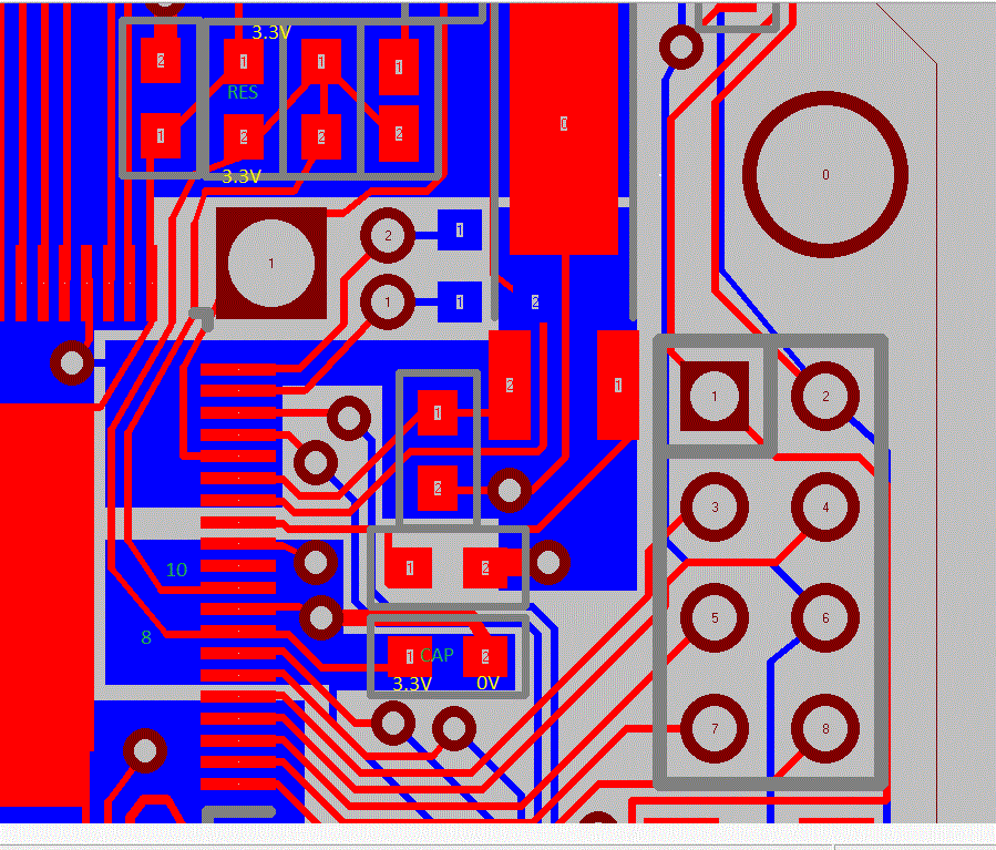

Pin 8 and 10 connections are routed under the LPC1751.
Picture enclosed below. You should see 3.3V on the 3 places noted.
There are around 6-700 rev 7 boards out there, but it is always possible you have one with a broken trace or an assembly error. If it were an assembly error it would be a wrong component loaded at the top where it says RES, it should be stuffed with either a ferrite bead or 330 ohm resistor. Or it could be a broken trace or cold solder joint.

Thanks for the PCB layout. I rechecked my voltages and I had 2.7 volts on the Vrefp and analog Vdd. I measured 0.5 volt drop across the 330 ohm resistor. I replaced the 330 ohm resistor with a ferrite chip bead that has 600 ohm impedance at 100 Mhz. Everything seems to be working normally now. Thanks for the help......Tom
