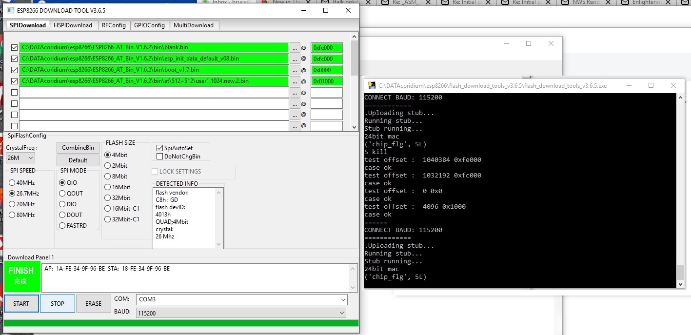

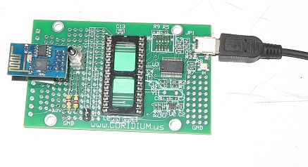

For now this is not an active product, but I had need for a G-job that could use it so I dusted off the old the old LPC824/ESP8266 combination.
First I needed to update the firmware for the ESP8266. Wow they don't make that too easy, but I had a BASICchip board that I midified as a downloader
I didn't think that was the hard part. Figuring out which tool and firmware version of ESP8266 and how to use it was a real pain. Among the many this got me over the hump.
https://www.electronicshub.org/update-f ... -firmware/
And the update process for the 1.6.2 version seemed to handle my older parts
And I got a new version loaded on all the ESP8266s I had
