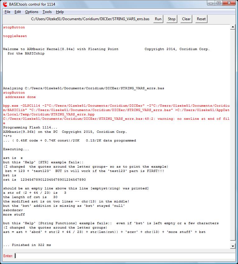

While investigating string functions for an LCD based Dice Roller project, I came across 2 errors in Strings.
Error 1:
this BT based 'Help'; topic [STR] example fails:: "
bst = 123 + "test123"
bst will remain empty.... --BUT it will work if the 'test123' part is FIRST!!!"
Error 2:
' the following line is copied from the BT based 'Help'; topic [String Functions]
' it fails to compile
'ast = ast + "abcd" + str(2 + 44 / 23) + str(len(cst)) + "zcxv" + chr(13) + "more stuff" + bst
Programming Flash 1114...
-ERROR C:/Users/Olzeke51/Documents/Coridium/DICEer/STRING_VARS_errs.bas: 43: Expected Operand
-ERROR C:/Users/Olzeke51/Documents/Coridium/DICEer/STRING_VARS_errs.bas: 43: expected expression
-First ERROR at line :43
I did test each of the "STR(functions)" individually and printed out their results -- see the .jpg
the attached files :: the .jpg shows Error 1 only - as I commented out the "Error 2" statement.
:: the .bas is my program with Error 2 enabled (and 'bst' is still empty

Re: String Functions issues
Some troubleshooting results, that might shed some light on the Error 2:
original code and errors:: on a Vista Home SP1; latest (5 days ago) 'setupBasic.exe',
-ERROR  C:/Users/Olzeke51/Documents/Coridium/DICEer/STRING_VARS_errs.bas: 44: Expected Operand
-ERROR  C:/Users/Olzeke51/Documents/Coridium/DICEer/STRING_VARS_errs.bas: 44: expected expression
1) replaced the '+' with '&' - no apparent change
2) using the '&' ; I moved some text between the two str() functions
and got different error messages::
ast = ast & "abcd" & str(2 + 44 / 23) & "zcxv" & str(len(cst)) & chr(13) & "more stuff" & bst
-ERROR  C:/Users/Olzeke51/Documents/Coridium/DICEer/STRING_VARS_errs.bas: 43: expected comparison operator
3) with just one of the str() functions in line::
ast = ast & "abcd" & str(2 + 44 / 23) & "zcxv" & chr(13) & "more stuff" & bst
-ERROR  C:/Users/Olzeke51/Documents/Coridium/DICEer/STRING_VARS_errs.bas: 44: expected comparison operator
4) removed the str(2+44/33) part only [str(len)) is back in]::
ast = ast & "abcd" & "zcxv" & str(len(cst)) & chr(13) & "more stuff" & bst
5) putting the 'text' between the str() changes the error printouts !!!
AND just either str(), added this error also!!! "expected comparison operator"
HTH - GaryZ
As the doctor said, "well don't do that"
the multiple str functions in the statement are too complex to be handled in a single line. I'll have to fix that example in the help files.
So you should be able to do --
ast = "something" + str(something)
ast = ast + str(something
That's for the first error, can you boil down the next one?
in the event you would need to take an integer (say of a temperature) and add it
to the word F or C, it would take two statements::
  bst = STR(123) + "test123"
-ERROR  C:/Users/Olzeke51/Documents/Coridium/DICEer/STRING_VARS_errs.bas: 18: expected comparison operator
-ERROR  C:/Users/Olzeke51/Documents/Coridium/DICEer/STRING_VARS_errs.bas: 18: Expected Operand
-ERROR  C:/Users/Olzeke51/Documents/Coridium/DICEer/STRING_VARS_errs.bas: 18: expected expression
-First ERROR at line  :18
you are right - the examples need to be changed
And the initial bst confuses the compiler with the implied string function. So it looks like you will need to do str(first_number)
bst = 123+"something"            ' DOES NOT work
bst = "something" + 123          ' works
bst = str(123)+"something"      ' seems to not work as a single line either
I'll look into fixing that.
Error 2 might be tied into the same underlying issue of "Error 1'
it will have to be broken up into multiple statements
and the examples reworked.
end of line
