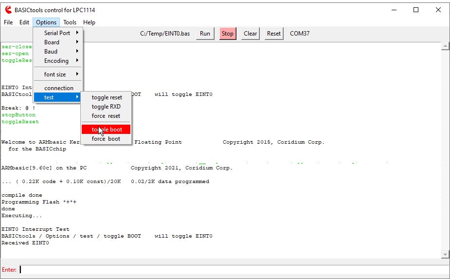

I will add this to the next release.
This uses the BOOT pin (GPIO0.1) which can be toggled by BASICtools. (I should change the label from EINT0 to GPIO0.1)
Source for
EINT0.bas
(2.98 KiB) Downloaded 3057 times
Re: simple Interrupt for PROstart
Updated the file to change the label to GPIO0.1 for LPC1114
Also program correctly for rising edge interrupt (default was falling edge).
