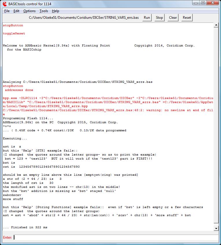

While investigating string functions for an LCD based Dice Roller project, I came across 2 errors in Strings.
Error 1:
this BT based 'Help'; topic [STR] example fails:: "
bst = 123 + "test123"
bst will remain empty.... --BUT it will work if the 'test123' part is FIRST!!!"
Error 2:
' the following line is copied from the BT based 'Help'; topic [String Functions]
' it fails to compile
'ast = ast + "abcd" + str(2 + 44 / 23) + str(len(cst)) + "zcxv" + chr(13) + "more stuff" + bst
Programming Flash 1114...
-ERROR C:/Users/Olzeke51/Documents/Coridium/DICEer/STRING_VARS_errs.bas: 43: Expected Operand
-ERROR C:/Users/Olzeke51/Documents/Coridium/DICEer/STRING_VARS_errs.bas: 43: expected expression
-First ERROR at line :43
I did test each of the "STR(functions)" individually and printed out their results -- see the .jpg
the attached files :: the .jpg shows Error 1 only - as I commented out the "Error 2" statement.
:: the .bas is my program with Error 2 enabled (and 'bst' is still empty
Error 2 enabled
(1.52 KiB) Downloaded 1323 times
a run with Error 1
a run with Error 1

As the doctor said, "well don't do that"
the multiple str functions in the statement are too complex to be handled in a single line. I'll have to fix that example in the help files.
So you should be able to do --
ast = "something" + str(something)
ast = ast + str(something
That's for the first error, can you boil down the next one?

Re: String Functions issues
Posted: Sun Nov 12, 2017 1:03 am
And the initial bst confuses the compiler with the implied string function. So it looks like you will need to do str(first_number)
bst = 123+"something"            ' DOES NOT work
bst = "something" + 123          ' works
bst = str(123)+"something"      ' seems to not work as a single line either
I'll look into fixing that.
Posted: Sun Nov 12, 2017 1:05 am
Error 2 might be tied into the same underlying issue of "Error 1'
it will have to be broken up into multiple statements
and the examples reworked.
