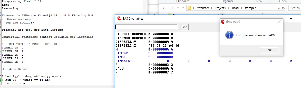

I got an error file while doeing a 'refresh' of the debug/Variables display --
lost commmunitcations
I created this log file by coping the window data into Notepad

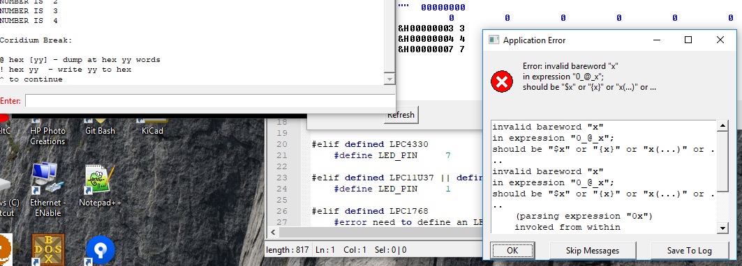

"save as popup" is the (TCL?) windoww that 'popsup' when you want to save the< log file> button
from the Error message window of ?Tcl?.

I created the same issue by interrupting the variable refresh process which became automatic at one point.
That interruption gets Stamp and PC out of sync, and you need to reset ComXX selection. So auto refresh of these windows is being disabled.
Save to log puts it wherever you tell it to (I assume).
