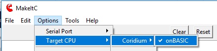

Ok, so I am messing around with MiC & ConBASIC. The end goal is to get Segger's RTT code installed on an Coridium ARMbasic Target. Reportedly, it is only ~500bytes so I feel it might be safe to do so and then make use of it with AB (after getting the ASM from the RTT code compilation effort).
So I delved into my first ever C dev effort on any micro. lulz. Anyways, I followed the getting started section and am somewhat concerned with what I am seeing:
I find it a bit hard to believe that a simple hello world app would consume 35K of compiled code. :)
I did get a TCL error during the compilation about 'adding multicore' (which I presume is due to my having the 54102 target).
Is it safe to presume that the flashing of this would fail, in a ConBASIC context?
