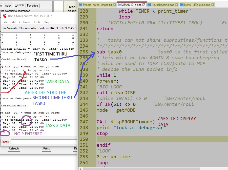

Anyways, that is getting down into the weeds a bit. Here is a screen shot of an early implementation of ABmt:
There is a dprintf debug serial stream that is bitbanged and is able to emit info at some 4.4Mbps via a gpio on a Coridium 54102 target (bit banged to mitigate impact of interrupts inside an ISR). The emissions in the image are highly verbose, just for testing/dev purposes.
The UI that you're seeing in the image is a project I've been working on, with help from BasicChip and Olzeke51. As a small bit of a spoiler alert, this will be a topic of a blog post where it is formally introduced, with links to an introductory video(s), and instantiation of a thread herein to offer it up to the user community.

Re: Multi-tasking - STOP command issue
Hey Y'all
I was trying to debug a 7-segment display Task0 that shows/displays junk in a MultiTask.bas program,
so I used a STOP command to be able to dump the "Tools/Debug/Variables"
I assumed (without any/much thought) that AB would stop processing program flow -
but the MT interrupt for time slice would just keep changing the stack pointers
(and such) but not 'DO' (continue running) the TaskX_Subroutines. ARMBasic was never
designed to be a multitasking/RTOS but Bruce has done a fine job of providing a framework
for doing multiple tasks - [it is a different mindset!!] - btw - Thanks
I am just pointing out the situation...just something to be aware of while you are debugging a program..
Also be aware that after several iterations of modifications;
the board (or BasicTools) gets confused and you could get incomplete information- reboot both of them.
The STOP command works but not sure of other effects.
will try later with PRINTs — going to do one big loop with IF/THEN flags that will
cause some GOSUBs to handle the events - the flags are generated by a seperate
Interrupt Service Routine. The PRINTs need to be short as there are several tasks
all using Interrupts and other resources such as RAM and IO.
FWIW - a tight loop; checking for an input would be the normal interactive way
of getting operator data via a terminal or touch-screen; not the STOP command!!!!!
Print "Press SW7 to proceed"
While IN(51) <> 0		'SW7/enter/
     flag = 0
flag = 1
Hope this helps save someone some time
Gary Olzeke
Re: Multi-tasking
You can always turn off the task switch interrupt, if you want to stop the other processes.
I have not tried it, but variable dumps will probably work in the STOP
