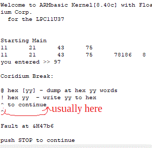

Hello Basicchip,
I am getting a 'hard fault at 47b6, fairly constantly.
after I enter a keyboard character !!
edit: changed the pointer to the correct value and it has not failed yet tho I did keep the 2nd MyByte2
'  **DO
    MyByte = RXD(0)
UNTIL MyByte >= 0
MyByte2 = RXD(0)
IF time_idx > 511 then goto Oops
print "you entered >> ";MyByte
'wait(1000)
'stop
Task_r()
a)the WAIT seemed to eliminate the hard fault ; else it showed up in Task_r() sometimes
b) stop was for locating hard fault -- at times it would fault BEFORE my stop !!
c)I added the MyByte2 incase the keyboard <enter> key was an extra character
. to try and troubleshoot the Break caret showing up on the next line
. ran blinky with a stop at the end to verify it is in the 'usually here' position
???? any comments about the function that is causing the 'hard fault @ 47b6"??????
1st  run
1st run
added mybyte2
added mybyte2

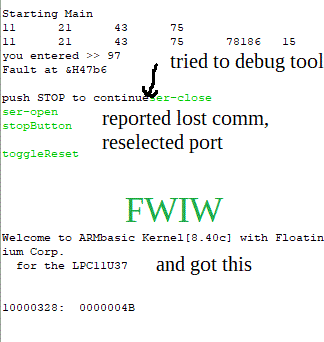

edit:: I am using Timer2 for a 50ms timing loop for my software RTC
adding a second "MyByte2 = RXD(0)" seems to have cleared the caret back to its "usually here" position

Re: ARMstamp 11U37 hard fault - WORKING NOW
A new day, more brain power....
well, actually had a slow time getting to sleep....
it dawned on me that &H47b6 was most likely in my program area!
sure enough, here is the Tools/Debug/Code data::
and you can see that Task_r is in that area!!
BUT - it doesn't explain the hardfault occuring BEFORE I call the Task_r!!!
I did find a possible cause - in that I was formatting SPRINTF wrong for the values I fed it ??
The bad pointer( as I previously mentioned) would just give me erroneous data
