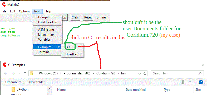

downloaded MiC today onto a W10 machine, had a 1114 board on it
tried to call up the 'example - HelloWorld" and ran into this issue in the picture
and got a confirming message still about __errors.tmp file permissions
(Issue 1 & 2 were run on a W7 machine from a recent d/l -MIC.tcl said v12.3)
Any thougts??
Gary
P>S> I noticed many times the file search looks for *.pde/ *.ino files by default !!!!!

Well the pointer to where examples and libraries can get reset for various reasons.
If you click on it you can navigate to the folder you want to use.

the file folder for examples IS NOT kept between restarts of MiC
still get the file permission issue on __errors. file

I can not duplicate your errors.tmp file problem. I have seen it when MiC has been open for a long time, sometimes overnight. Closing MiC and restarting has always cured it. Maybe time for a Windows reboot.
Re: MakeItC_v12_3 - issue3?
Posted: Wed Jul 22, 2020 9:11 pm
OK installed on a virgin Win10 system, and I could duplicate the errors.tmp issue.
Fixed and new installer https://www.coridium.us/files/setupC.exe uploaded.
