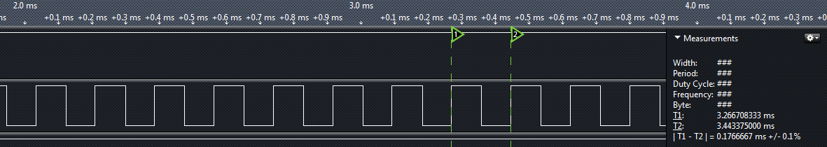

I am having trouble getting the software PWM to work on the LPC812 BASICchip. Using the code below, no matter what value I pass in for 'milliseconds' the period of the PWM out is 176 microseconds (see attached logic analyzer output). Changing the duty work fines but the period seems to be always 'locked' to 176 microseconds. Any ideas?

So, After looking at the PWM code (instead of just assuming I knew what the code was doing). I realized that I was trying to use PWM wrong.
I wanted to hook up a Servo and I saw the PWM function and thought "Perfect, I don't even have to write any code!"
I thought that the milliseconds parameter was used to set the period of the pulse not duration of the pulse.
MY FAILED BRAIN:
I thought if I called PWM(15,128,20) that I would get a pulse train on pin 15 that was "high" for 10 milliseconds and low for 10 milliseconds.
REALITY:
In fact PWM(15,128,20) will output a 50% duty pulse train on pin 15 with some predetermined period X (which i measures as 170 us) for a duration of 20 milliseconds
The PWM function makes sense I just had my "Servo Blinders" on for the past 2 days.
-Dan
P.S. I was never actually hitting the 65 millisecond bug in any of my code. The "bug" I was running into was that I made a bad assumption that PWM worked how I wanted it to work at the moment. The PWM function as it "imagined" it would not be very useful dimming leds etc :)
