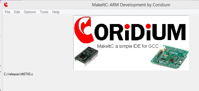

Z001-
When you start MakeItC it should show a gray screen, but with a Coridium MakeItC Flash If you don't see that picture, setupC didn't run correctly or that picture core2.GIF is missing (the very first time you run it you will see core1.GIF)

Z001-

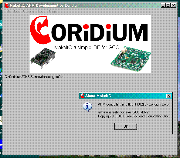

Well, this is where the evaluation hits the pavement.
Z001 - still open - see my 2nd_start vs. your core2
I uninstalled the old makeitC, downloaded the latest from the tech support page and installed it in c:\Coridium\ folder
[Basic was also installed to the same directory !] Fired it up - got the core1.gif on grey, selected 'demo' mode -(serial device)
[I am assuming C found a 'com9' port but not being enabled - it didn't prompt me for any serial devices]
SHUTDOWN immediately
restarted and got the core2.gif BUT still on grey background. I selected Help/About then did a crop of a 'printscreen' via
windows and Paint -- here is the pix - see attached
