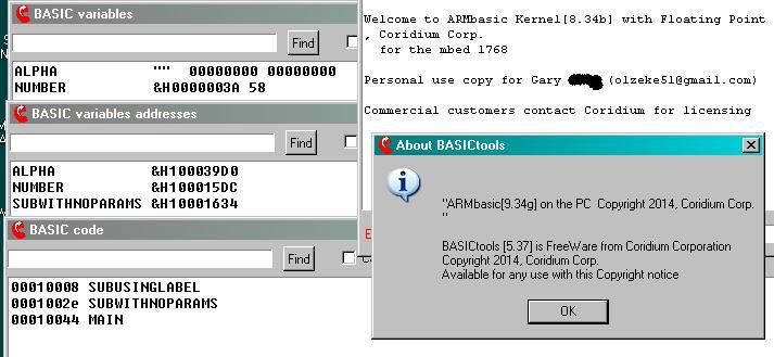

downloaded the latest 'setupBasicTools.exe' from the mbed page
ran the examples for the "calling function" from the other day that you sent to the forum
[I did add an "alpha$" and a "number" for indexing]
/// inline code STOP worked
issue 1 the key combo of <CTRL-R> wouldn't reload a file but the pulldown menu would.
(I'm not using my script but yours for the TCL - fresh install) works ok on the BasicChip
possible issue the BT 'variables addresses' included a subroutine address
///SUB SUBwithNOparams
print "do something else"
END SUB
//// maybe the string part is what is being referenced -- had not paid attention to it before.
