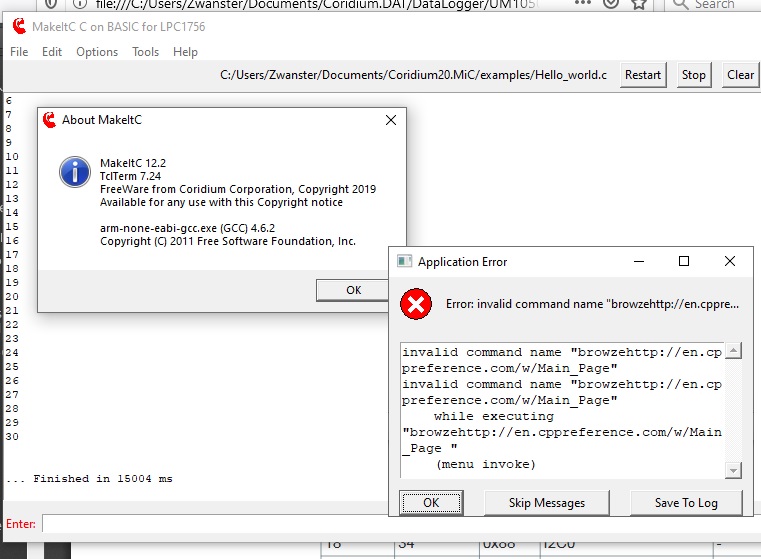

Hey Y'all,
Used a version of MakeItC (loaded 3/26/2020) and ran Helloworld.c example.
wanted some info on C - so I did the Help tab, C reference and got this error -
the site does exist if I manually type the URL in FireFox (on Win10)
?? missing space after the 'browze" ??
