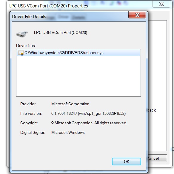

The USB serial adapter we use does use an FTDI device.
but the ARM Stamp DOES NOT use an FTDI device, so any trying to link to that driver would most likely cause issues.
The ARM Stamp reports as a USB_SER device and expects a Microsoft driver. This is what I see on my Win 7 machine.

Same for me, exactly, same version and date.
but in my system, sometimes, when you have to record the program, it gives port error and it disconnects, and I must restart windows. It can be my windows failure, because I have many different programming units, like TEENSY, ARDUINO, XILINX (by JTAG and by USB_SERIE, like the "Papilio").
Perhaps, too many devices installed, and each with its drivers, that collide with each other.
