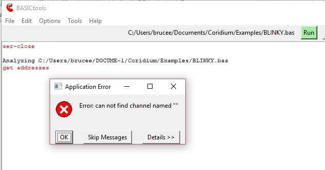

The other thing is what is this error message supposed to mean?
Error: cannot find channel named ""
A screen shot would really help me see why this occurred and is why I added debug messages into BASICtools 6.02d. You can email me the image. I usually Ctrl-Print-Screen, then open Paint, Paste, then crop the important area.

I have not yet figured out how to reproduce the event. It is not something to do with the Basic code, it is something to do with attempting to load/run the code. Other times the Basic code runs fine.
If there is a separate window for debug messages for the BASICtools code please advise on how to do that.

The debug message show up in red in the BASICtools window. I think I just stumbled upon one of the errors. I just refreshed the Serial Ports, and then tried to compile a program. Refresh use to leave a COM port open, now it does not and then fails.
The work around until I fix this is to select the Com port after a refresh. This is the kind of thing I would want to see
Re: Drivers Win7 for LPC11U37 "kickstarter version"
I have fixed the serial com error robots42 and most likely jepalza reported. These bugs show that I always do things a certain way, and someone else might not do it that way.
Windows can still get confused, opening and closing and having multiple copies of the program open, such that you may need to disconnect the USB connection and close all the Coridium programs and start over.
New versions of setupBASIC and setupC posted. you can just install them, they overwrite the existing programs. This is version 6.03d
I am running 6.03d.
BASICtools indicates /BLINKY_DB.bas and Com27
I have still sometimes got the 'can't find channel' message on Open or Reload
see below
Analyzing C:/Coridium/Examples/BLINKY_DB.bas
get addresses
can not find channel named ""
while executing
"fileevent $::ser_port $whatevent $action"
(procedure "serialevent" line 5)
invoked from within
"serialevent readable getADDR232 "
(procedure "readAddrList" line 4)
invoked from within
"readAddrList"
(procedure "getAddrList" line 17)
invoked from within
"getAddrList"
(procedure "cppOnBASIC" line 28)
invoked from within
"cppOnBASIC $file2send"
(procedure "compileFile" line 11)
invoked from within
"compileFile $file2send"
(procedure "runButton" line 13)
invoked from within
"runButton"
(procedure "resendFile" line 11)
invoked from within
"resendFile "
