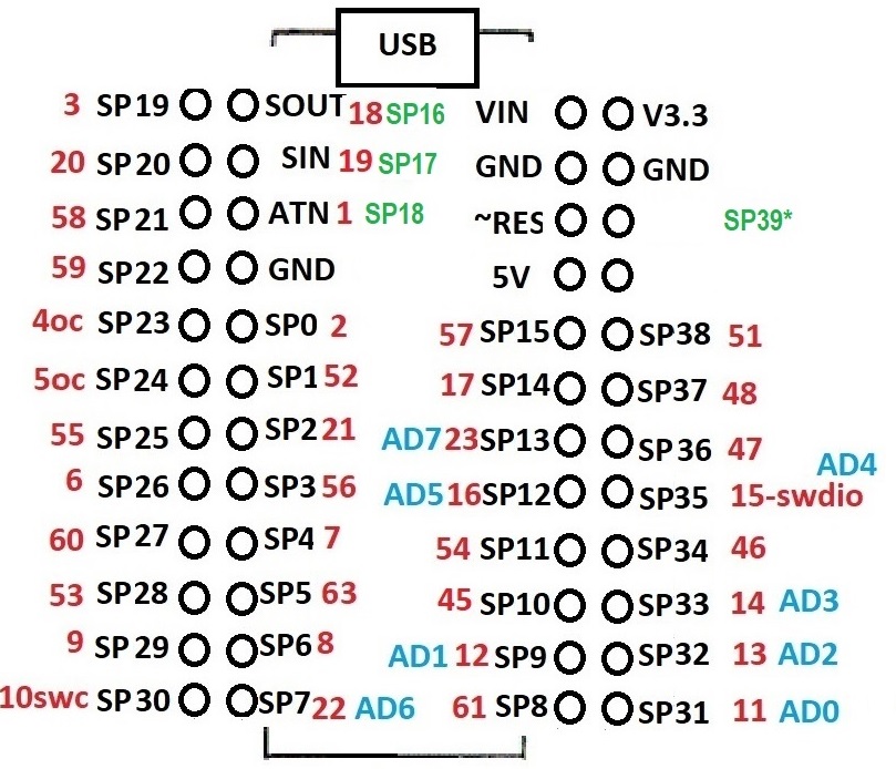

Could someone please point me to the documentation specific to the new ARM stamp - LPC11U37?
Neither the pin-out nor the setup procedures seem to be covered in the ARMbasic.pdf, for example.

Re: ARM stamp - LPC11U37 Pinout
Sorry, looks like I need to update the PDF version and I will for BASIC. C is still being written for LPC11U37
There is a link in the CHM/HTML help docs and a link from Help in BASICtools.
That link goes to here -
http://www.coridium.us/ARMhelp/index.ht ... 11u37.html
The numbers in red indicate NXP port/pin definition, which Port0.31-0 are 31-0 and port1.31-0 are 63-32
oc indicates the pin is open-drain or equivalent to open-collector
swdio and swc are SW debug pins. On reset they are SW pins, but when BASIC starts these are made to be IOs
The SP numbers in black are defined in the #include file STAMP_PINS.bas. They are also #include'd by LPC11U37.bas
SP numbers in green are special purpose pins, but can be used as IOs with restrictions -- see help files for more details.

Thank you 'basicchip'. The PDF that is downloadable at https://www.coridium.us/files/ARMbasic.pdf doesn't seem to reflect the update that you made at https://www.coridium.us/coridium/helpfi ... -basic-pdf. Perhaps there's still some process that needs to run to make that happen? (Took me a while to realize that these are actually different files; the one that's easy-to-get is the obvious one to download ... but it's not the one that was updated!)
Is there a PCB schematic available? Something equivalent to "BASIC Stamp BS2-IC Module Schematic Rev. J"?
Is the pin diagram as seen from the top of the PCB? Although the PCB has a clear label on "1" it's not clear to me that on the LPC11U37 that SOUT is the corresponding "1", although I can infer that from the BS2 schematic. (Like I said, I'm a newbie so I'll undoubtedly ask questions that are naive -- but maybe they'll help to improve the documentation for folks whose entry-point is the LPC11U37 and never had the opportunity to work with the earlier Stamps :->.)
Regarding "Connect the ARM BASIC Stamp", will the stamp self-power from the USB for this preliminary exploration or do I need to get it "wired up" first? I'm guessing the latter. On the BS2 schematic it appears that there is an onboard regulator and thus VIN can be used to derive VDD. Is that also true for the LPC11U37 and both 5V and V3.3 can be derived from VIN? (What are three-pin D1 and U1?) What are the requirements regarding VIN (feeds D1) and its relationship to 5V and V3.3? Yes, a short tutorial regarding how to set up the LPC11U37 (think breadboard) would be very helpful ... at least to me.
Thank you,
paul
All the file pointers point to the same file on the web and that has been updated. You might still have an old copy that you downloaded.
That help file also includes the schematic, that I will link to below.
All of our boards can be powered from the USB, and have diode steering so they can also be powered from the system they are plugged into. Speaking of USB, in the pin diagram above there is USB with a box around it, that is the USB connection for orientation.
Download and run setupBASIC and launch BASICtools, and it has all these links too. The schematic is at
https://www.coridium.us/files/Schematics/LPC11U37.pdf
