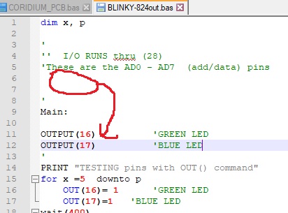

RESOLVED......
the pin configuration needs to be in the 'Main:' routine .... NOT before it.
FWIW - a 'label:' routine needs a RETURN , not an ENDSUB to close it out......

Yes inline execution begins at MAIN: if it exists. The compiler currently warns about inline execution of SUB/ FUNC if there is no MAIN. I will look into a possible warning on OUTPUT and the like.
