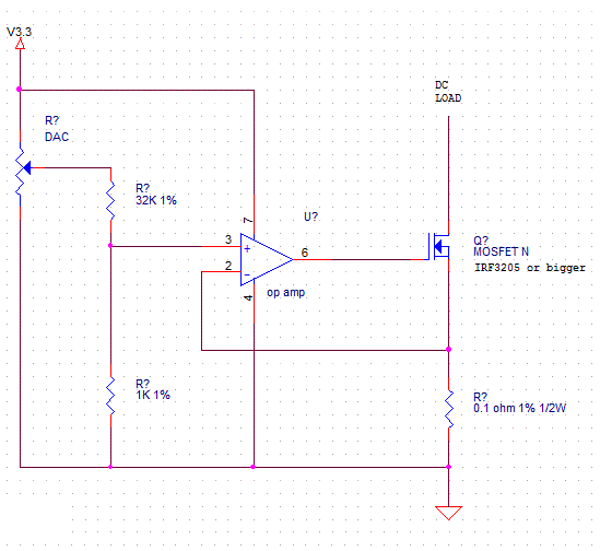

>from the Yahoo Forum
>looking for a 1A controlled current source
A current source can be built with a DAC and a resistor divider in your case to get a 0 to 0.1 V reference, an op amp for feedback with a big MOSFET with a low resistance and small current sense resistor (remember it's dissipating a lot of heat)
Values are not exact, but the general idea

I was thinking along those lines. I'll ned an Op Amp that works on a single supply, and a way to mount & heat sink the FET, also a DIP or SIP DAC.

I'm looking at a Maxim MAX517ACPA DAC, and an NXP BUK75144-55A,127 for the MOSFET. I need through hole mounting for the DAC. I still need to identify a single supply Op Amp.

The parts that I selected are from Mouser. I'll try Digikey next. I have purchased from both in the past. I will look for another DAC, because the Mouser unit is a Dual and priced at $3.73 ea for 1 to 25 units.
In the Dual DAC setup each DAC uses a seperate External Reference, since there are two DACs in a package, I could use VCC as a reference for one, then connect the 1st output to the Reference of the 2nd DAC. Then I would program the 1st output to be x/256, and I wouldn't need a Divider for the OpAmp input. The 2nd DAC would directly drive the OpAmp.
