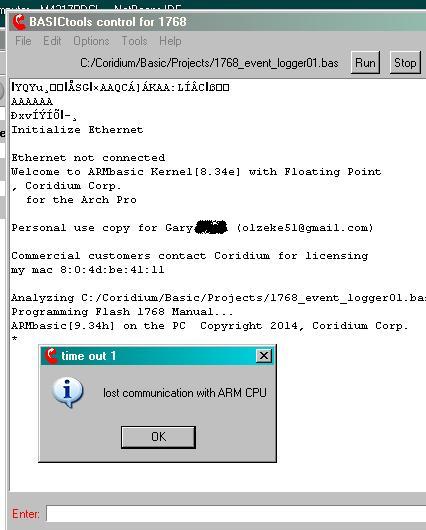

Got around to checking out the ArchProweb.bin file (for mbed). Tried loading a working program for the 1768
I keep getting "time out 1" popup windows -- attached file
went back to the latest earlier version of mbed1768web [Oct 02- from Mike]
and it loads okay. attached text file is a BT screen capture to show initialization (no ethernet & then ethernet)
update
loaded a fresh short program - 13 lines
loaded on the old web.bin OKAY but on the new .bin file---
Got a little further on the new APweb.bin
Analyzing C:/Coridium/Basic/Projects/ArchPro/test_short.bas
Programming Flash 1768 Manual...
ARMbasic[9.34h] on the PC Copyright 2014, Coridium Corp.
then the Time out 1 popup
ArchProweb.bin comm error

- time out pop-up
- archpro_bin_1.JPG (42.36 KiB) Viewed 34525 times

Re: ArchProweb.bin comm error
well, here is the 13 line program that wouldn't load on the newer.bin file

Try connecting the Ethernet, you may be running into long timeouts due to our assuming the EMAC is responding. It is continually polled by the firmware in case there is web traffic.

Bruce, I did have the ethernet connected - it failed connected or not - on the new .bin
My computer is looking like it is a possible suspect. I still get 812 comm issues - occasionally.
and now the ArchProweb.bin _ though the 1768web.bin didn't give me issues - AFAIRemember.

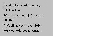

the main issue is with the download of the compiled / modified Intel-hex formatted file. It seems I may have
an overloaded computer and the virtual /USB comm port is an issue. It seems to effect the comm with the '812 I was
evaluating also - NOW I have the excuse I need to get a new computer '
Your screen shot showed --
Initialize Ethernet
Ethernet not connected
This will probably be a feature as it may be a lot of extra code to detect Ethernet not connected as the timeouts are long. And we really do assume the web version is plugged into a network and that is how we do our testing, especially during code development.
If your really don't want to use the network use the non-network version.

Oh, by the way... if you're running XP on that machine, Gary, it should be fine, unless you've got it clogged up with all sorts of plugins, add-ons, and background daemons. XP runs USB-based virtual serial ports just fine all day, every day. You are kind of tight on RAM, though.
I have an "octopus" multi-serial USB interface I use on the bench for troubleshooting. I use XP for a number of reasons, and I've never had throughput related problems below 115200 baud on up to four ports at once.
swapped USB ports from the front of machine to the back panel
I noticed when I copied the AP.bin file that the light pattern was
different from a previously good load of 1768.bin.
good red-flash - 1sec? - Yellow 1/3sec - 1.5 sec? - 2 short yellows
fail red-flash --------------- ? 3/4 sec ----------2 short ??grn/yellow ??
and then sometimes 5 secs later or so - will get a failed.txt in the mbin folder !!
reloaded the AP.bin file from my gmail account and got the same (type of) results.
but not the 'failed.txt' [only did the AP.bin reload once or twice]
will try to get another copy of my AP.bin file (ArchProweb.bin)
